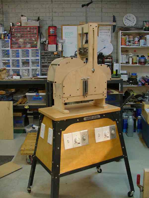

This isn't really on topic, but it is close enough...
here is a little contraption I built. It keeps everything nice and compact. It is a direct rip off from another that I saw (... sorry, I forget who...)
I generally use 2 blankets. The left controls run the left recepticle and the right controls run the right recepticle.
I used 1000W dimmers.
The final thing I want to do is add a couple of shelves to the bottom of it so I can store all of my bending forms below.
PostPosted: Sat Oct 08, 2005 12:09 am
Wow, Brock    THAT is a nice set-up!!
PostPosted: Sat Oct 08, 2005 1:18 am

PostPosted: Sat Oct 08, 2005 2:18 am
Yeah, it might be a bit over the top... :-)
I have a few ideas about hot-rodding the actual bender too.... maybe as I get time I will work those into the mix.

Nice one Brock,
That picture explains a lot.
Thanks for sharing!
